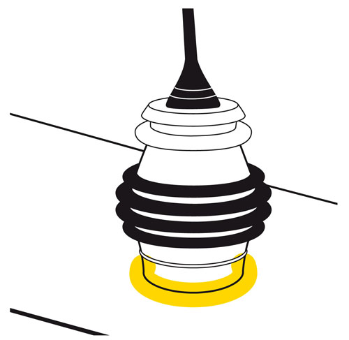

Deck coverings / teak decks (refer to 4.1)
Bedding and sealing of fittings and hardware (4.2)
Bonding of rub rails and fenders (4.3)
Sealing sacrificial anodes (4.4)
Bonding decorative panels and work surfaces (4.5)
Bonding lightweight internal partitions (4.6)
