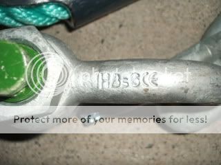

    I use galvanised chain and galvanised shackles. As Vyv mentions above, every winter it is gathered up and dropped to the bottom into the anaerobic mud of the bay. Thanks for illustrating the corrosion by abrasion issue Vyv - what was the seabed matreial in the area in which that chain was used?
    To compare the before and after shackle size, I am posting a pic of the replacement shackle which to the best of my knowledge is very simiar to the corroded shackle above.
    I agree with VicS that one has to be extremely wary of shackles of unknown origin from whatever source. The green pin shackle in the next pic come with a CE mark and I assume they are of a good standard. I would be interested if anyone has any comments on their performance.
    Green pin shackles are a trade mark of one of the better hardware companies and as they are extensively used in the offshore business and shipping they should be OK for you.

    Thanks for the link Bilgediver - must give their catalogue a look. Are all green pin shackles vanbeest?

    On the Shannon estuary moorings are similar but all use riser chain. Rope can get caught on keel during change of tide as there can be strong currents. It is almost unthinkable here to put a boat on a mooring at the start of the season without first inspecting the mooring. Shackles are changed annually and riser chains every other year, sometimes they can last 3.
    Tested shackles (green pin) seem to fare better. PTFE tape on the threads can preserve them and aids removal. Dont even think of putting grease on anything down there!
    It is usual here to use uncoated ground chain with galvanised shackles, swivel and riser chain. Anodes for chain are usually magnesium/aluminium type but are seen as prohibitively expensive for their effectivness around here.

    I disagree re quality of shackles (and chain) the only thing you need is iron. So far better a bigger shackle of unknown origin than a high quality fully tested shackle that is smaller. In a mooring the gear needs to be so big that actual strength is not an issue. You need large size so large amount of wear still leaves a lot of metal.
    In Belfast Lough and Strangford Lough it is prudent to change shackles every year as they seem to corrode very quickly as per the photos shown above in some of the postings.
    As for the green pin shackles; my son works in a chandlers and was advised by the traveller from a shackle company that the green pin shackles should never be used under water, they are supposed to be 'high tensile' or very tough, so corrode quickly in sea water.
