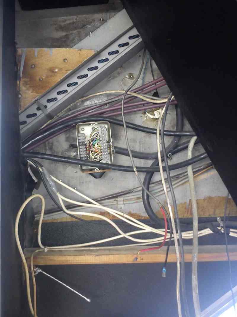

    small update,
    removed the quarterpanel (fairly easily after all) and saw the cabling mess under it. After a couple of hours of work, I've figured out where most cables go and I've removed a few more redundant ones. Wonder why ppl don't remove cables once they decide to remove the equipment.
    Anyway, Q panel now looks like this
    Removed a few things from the f/b arch and started the up-down trips figuring out which cable from the bilge (A/P controller or aircon) goes up to where and following which route. Will need one evening say 8-midnight to label and check all the remaining as I tend to loose time by going there for 2-3hours at a time, involved in a series of things and rechecking the same errors/oddities time after time...

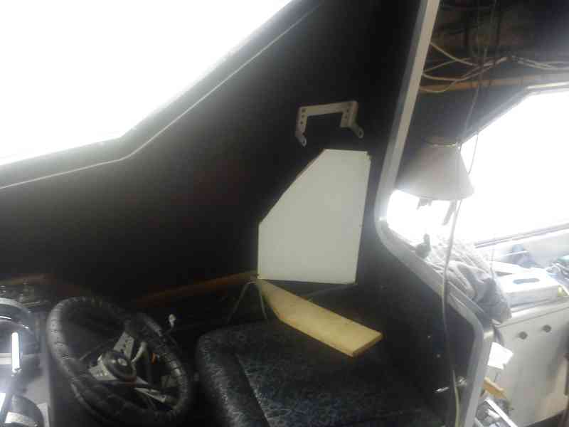

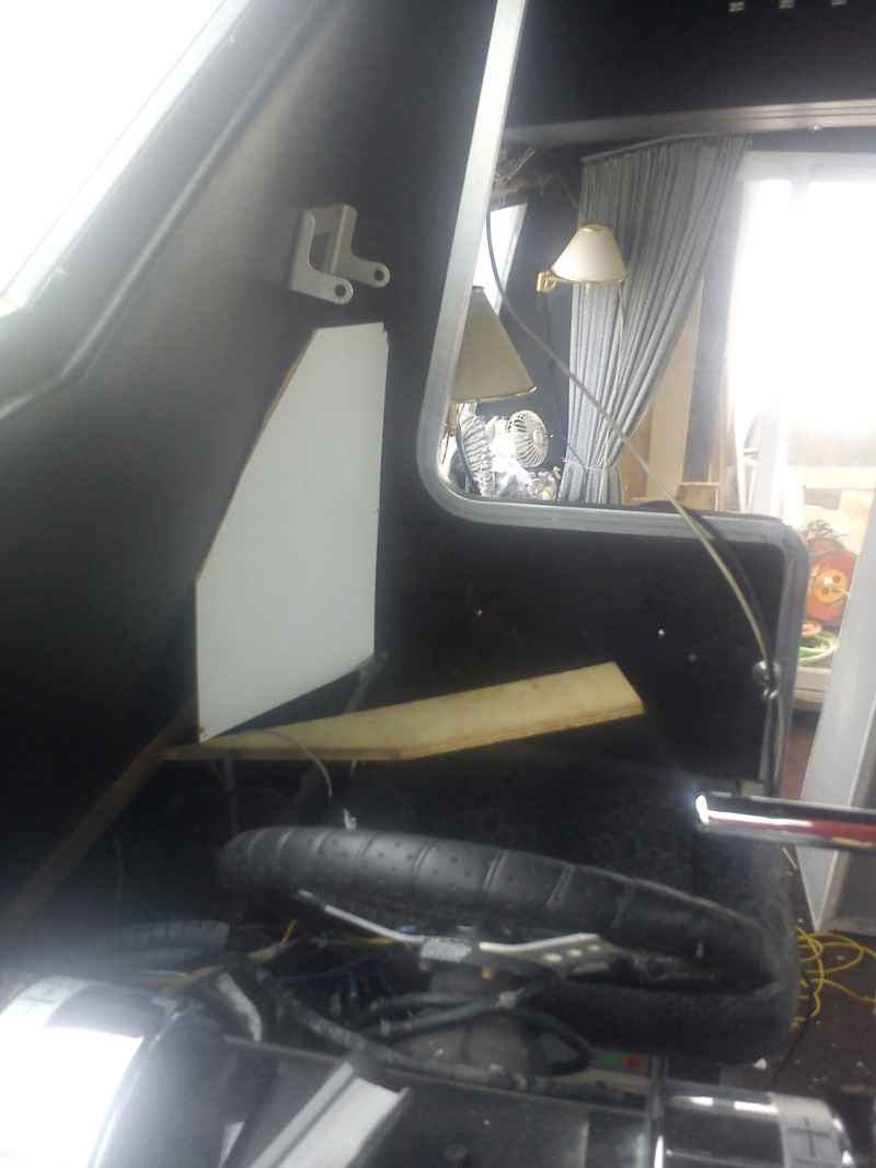

    Anyway, things are progressing fine on the wiring front and I should be fitting the gauges on the new panel v.soon (preparing the lining of the lasercut panels with leatherette as I type...)
    Finalising the placement of the extra relays/equipment for the BMS system and made a quick mock for the placement. It's not affecting ergonomics, it should be simple to construct and give me ample space for 24U plus few bits and bobs.

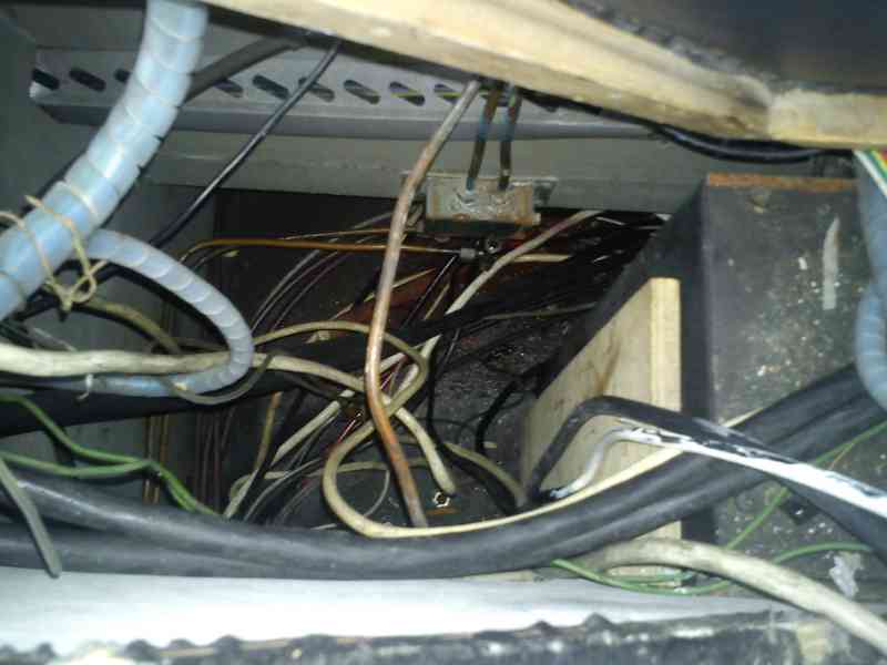

    Another morning worth of work today and the pile of redundant cabling is building up.
    I'm now at 95% clear and tidy on the lower helm cabling front just need to sort out a couple of glitches in supply to particular switches that is plain wrong or missing, wont be difficult or take long.
    Hence the well full of cables to the sbrd of the helm is now much lighter in cabling and easier to access the leaking steering box. Tried to tighten the nuts to no avail so I'm afraid I have to carefully clean all of them and spot the leaking connection for treatment, dirty job on a tight spot stretching my back and the rib, so we'll see when I'll make it.
    Still one bl00dy cable live 24V coming from the e/r and not through the fuses/el.panel, god knows why they've done it when the el.panel is next to it!
    Tomorrow I'll spend an hour or so in the e/r to remove a couple more cables going up to the helm area and trying to trace that cable back to the batteries.
    Also got to sort the old detroit engines cabling still intact taking space but I'm not confident that it's feasible.
