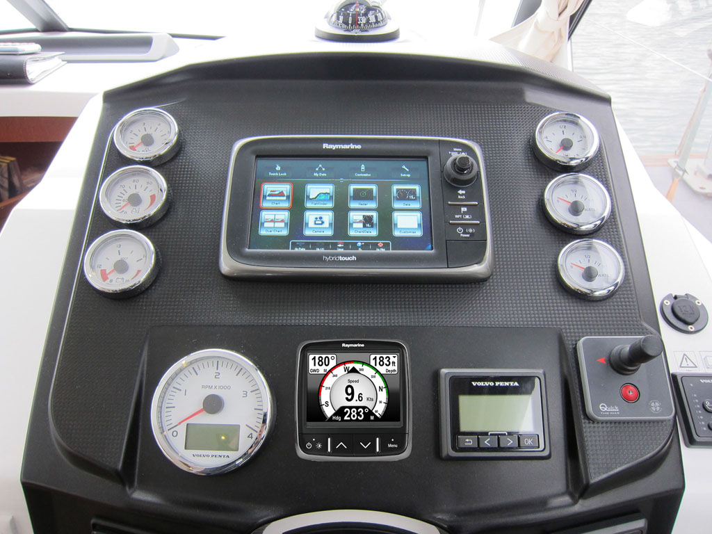

    New bow thruster is Quick, anyone know how they compare with Max Power?

    [QUOTE=Anders_P42;4377646]New bow thruster is Quick, anyone know how they compare with Max Power?
    [QUOTE]
    looks like a max power joystick with a different escutcheon to me..............
    Got a pic of the thruster?

    [QUOTE=Elessar;4377861]
    Quote Originally Posted by Anders_P42 View Post
    QUOTE]
    Boat was in the water, link to Quick website
    http://www.quicknauticalequipment.co...&ms2=6&ctm=221

    definitely not the same.
    max power did a twin prop 45kg f in a 125mm tunnel, sidepower does a 40kgf single prop.
    the 40kg f in this range is in a 150mm tunnel. Can't possibly see that fitting as it's tight as it is.
    So sidepower it is, and then you have issues with control interfaces or accept non matching joy sticks. That's why I liked maxpower, could fit a double joystick. 2 singles on the fly will look awful dues to lack of space.
