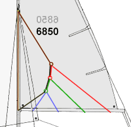

    Home made lazyjacks. 36ft, fully battened. Can be tied back to mast when hoisting the main if not directly head to wind.
