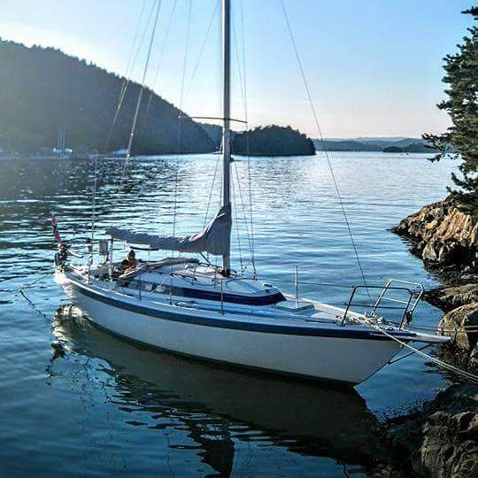

    My boat (Artekno H35):

    Contessa 32 is not so far from the construction of my H35. A little wider and shorter.

    From that photo, it would seem that the boat reaches under spinnaker with a quite neutral helm. That's a good sign if you're trying to self steer!
