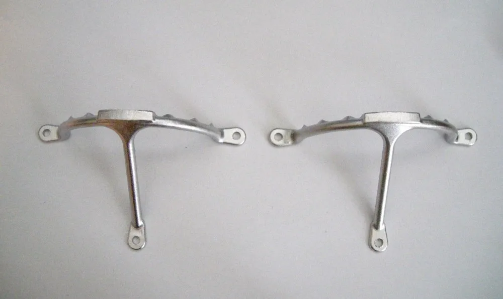

    When I fitted steps to my mast I looked at the type you are thinking of as I could also make those type but I decided to go for plastic folding steps fixed with stainless cap head machine screws tapped into the mast. One of the issues with fixed steps is the halyards getting wrapped around the steps I do find this if I leave one of my steps open.
    I also have two steps at the top such that the top of the mast is at chest height and I also have a strap that goes around the mast when working.
    I also use a boatswain's chair tailed by wife as I climb.
    BTW I'm way past middle age and my mast is 15 metres above deck.
    https://www.google.co.za/search?q=pl...EIKjAA#imgrc=_
    This is an interesting design that may prevent the halyards catching on the steps that could be easily fabricated from stainless rod adding a foot slip guard.
    Those answer the issues of 3 point fixing to prevent loosening over time, as well as being a "non-catchy" shape, and also supports my view that it is important to be able to put a foot down firmly on to a known position, rather than fiddle around for seconds trying to locate a gap.
    I like them. Nice one Roger.
    Better to rivet - M6 would only engage on a couple or so threads.
