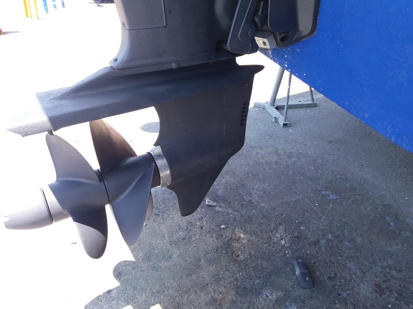

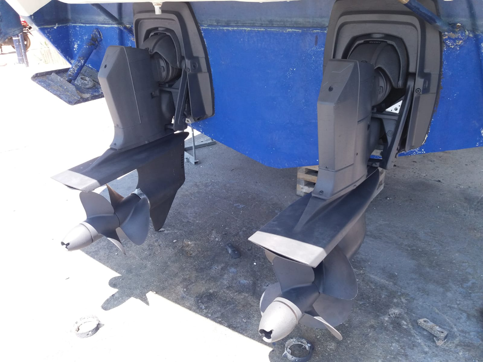

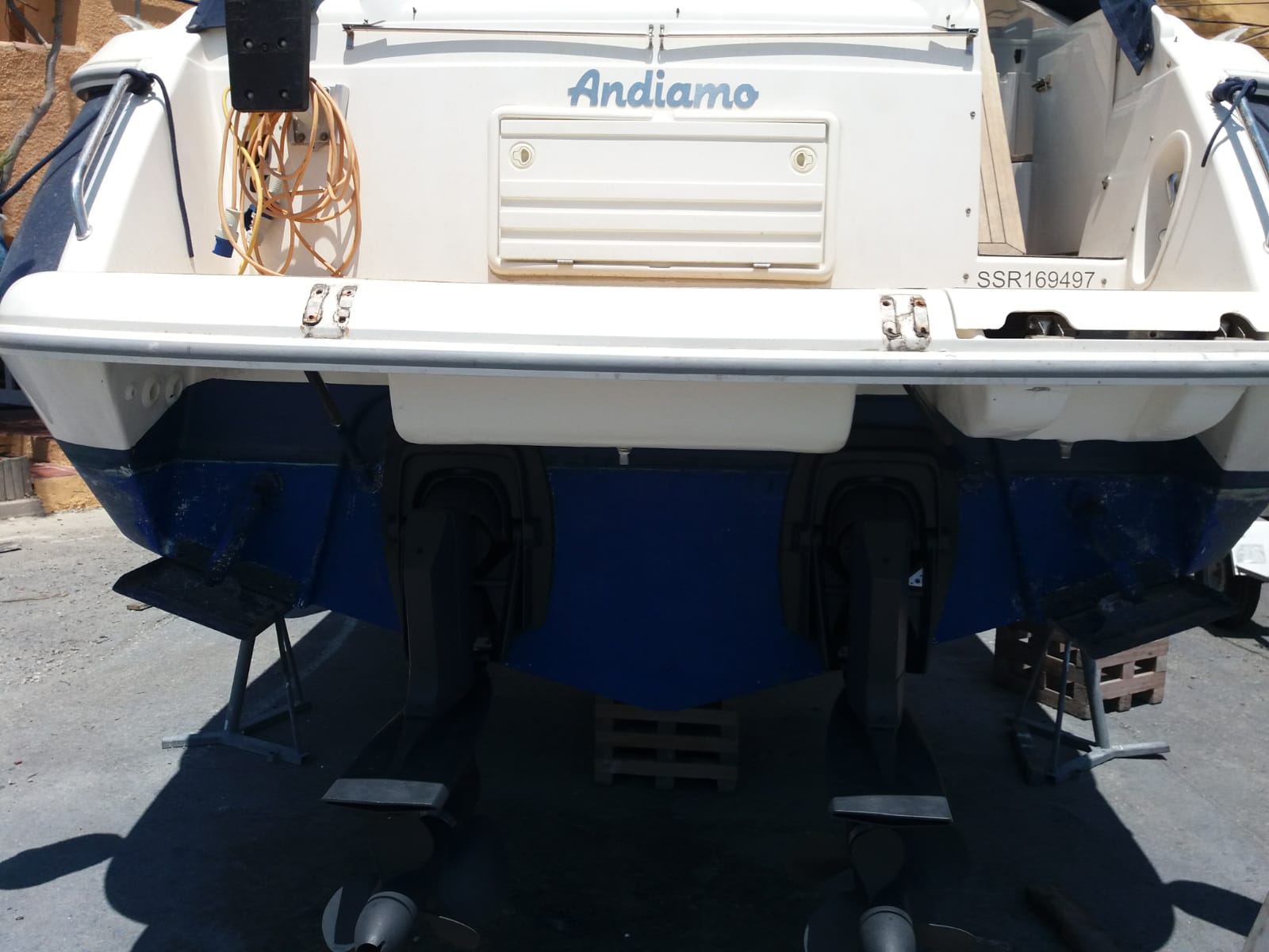

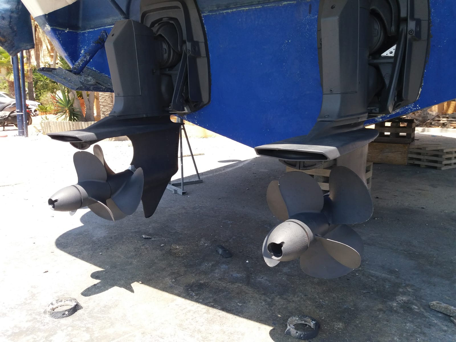

    Quote Originally Posted by MapisM View Post
    props of your boat (whose shape btw I can't for the life of me remember)—-/—— D
    Here you are - different
    https://imgur.com/a/Kle6R

    Quote Originally Posted by Portofino View Post
    Props look fine to me. you have to assume builder tested plenty on hull #1. The trailing edge of rudders and non recessed P bracket feet look draggy on such a fast boat. I'd want them faired.
