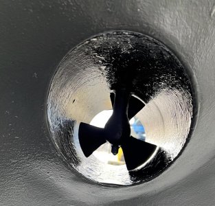

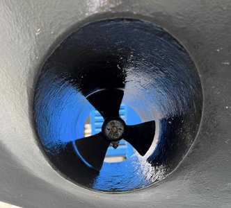

    Update and some questions:
    I managed to get access to an underwater camera to inspect my bow thruster prop without lifting the boat. What I found was that the prop is still present and the nut holding it onto the shaft is also still in place. So now I think there is a real possibility that a shear pin has gone on the prop shaft and that I might be able to replace it in a couple of hours with the boat lifted in slings rather than taking it onto the hardstand (I'm an optimist!!). Can anybody answer some of the following questions, please;
    (1) Does the Nobels bow thruster have a shear pin on the prop shaft?
    (2) If so what is the spec of the shear pin (so that I can get the correct replacement before lifting the boat)?
    (3) What is the spanner size for the nut that holds the prop on the shaft?
    (4) What is the size of the split pin that secures the nut on the prop shaft?
    If anyone can answer some or all of these questions and/or offer advice on the repair I will be most grateful.

    Default Re: Bow Thruster Problem Advice sought
    Thanks hg2016 for the suggestion but the photo taken by the underwater camera showed that the prop is not impeded by anything.

    Update:
    I used the underwater camera to make a video of the bow thruster prop shaft and it showed that the shaft was not moving when the thruster was activated. This indicates that the problem is in the gearbox (and not a shear pin as I had hoped!!). Now I'll have to wait until the next haul out to dismantle the gearbox etc. I'll post an update here later in case it might be useful to someone else in the future.
    Thanks to all contributors for their advice and support.
