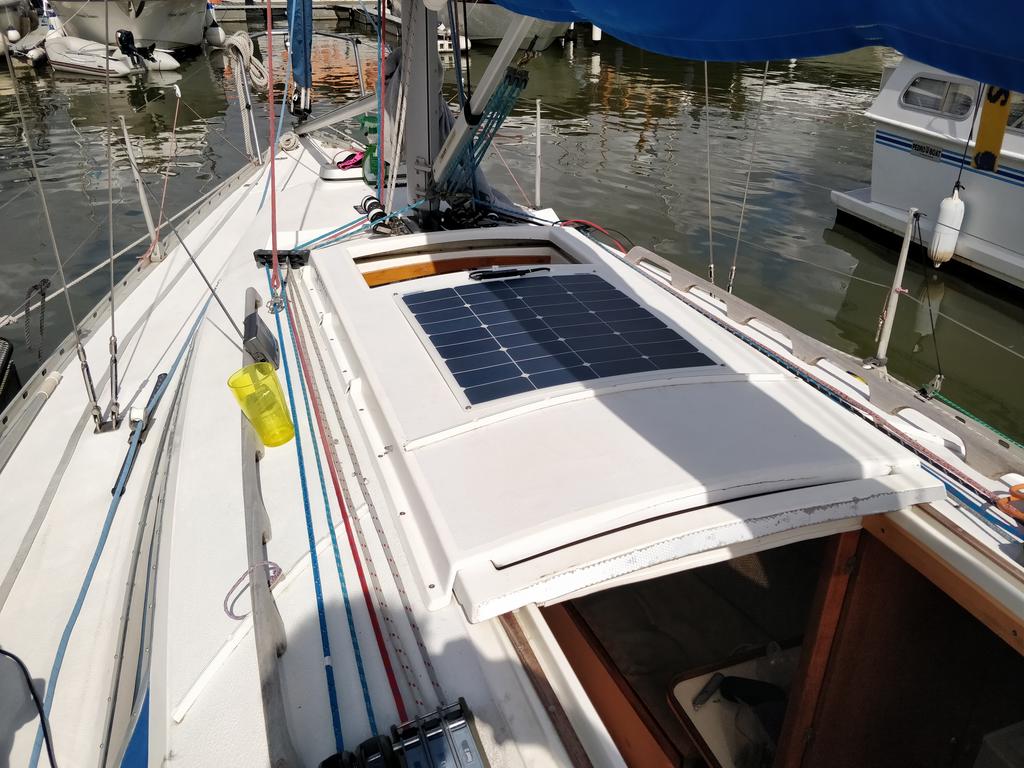

    If you're mounting onto a hatch garage that the hatch slides under then I would say just screw it down. You aren't penetrating the deck so no need to worry about sealing, and then you take it off easily if you want to.
    This is how I mounted it in mine, in hindsight a solar panel with back connectors would make a much more streamlined installation.
    Its a 50w panel, and to be honest I wasn't to impressed with the power it made, the location is the real problem, too easily shaded.
    If its directly to the deck I would bond it on so you aren't drilling holes in your deck.

    It is on the "garage hatch" so I may go for the screws then ...
    The cables will come back under the edge of the dodger and enter the instrument pod through existing holes.
    As you correctly noted, shading can be a problem, it only takes part of a "string" of panels to be shaded and the whole string loses power. effectively, the current output of the string is limited by the current output of the most shaded cell.
    I just want it to keep the batteries "topped off" while hanging on the mooring, so it doesn't need to do much.
