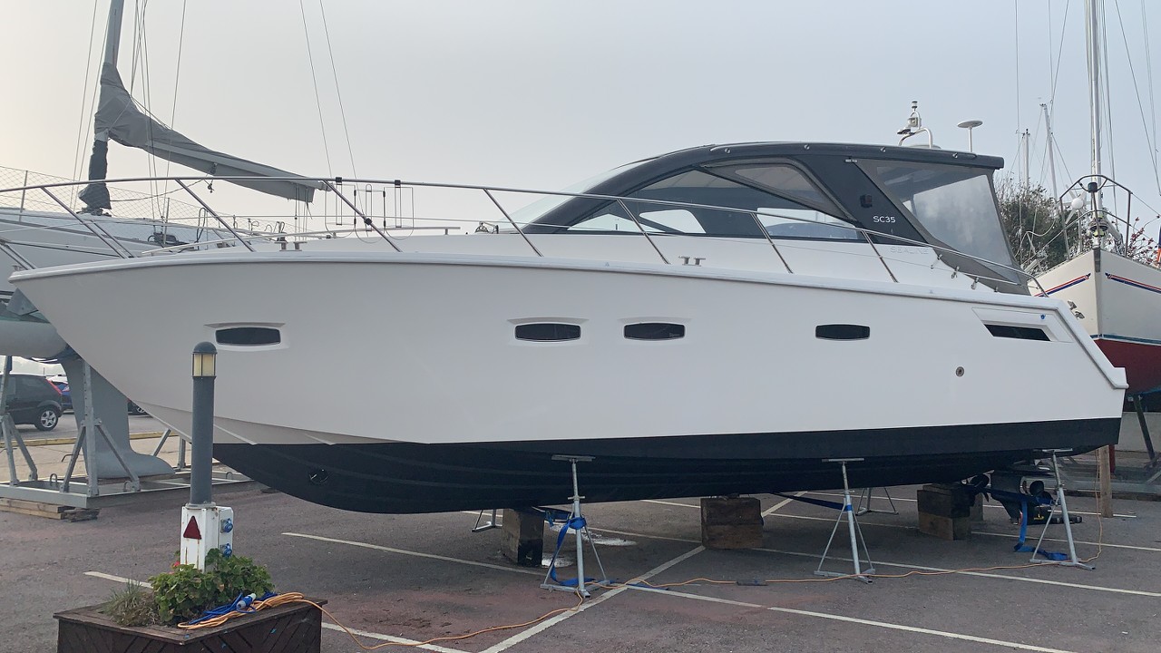

    SC35?
    No ladders to contend with either ...
