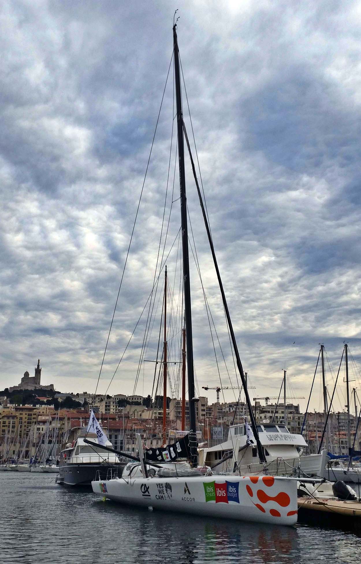

    So, here goes: I'd be curious to hear the rationale behind the rather peculiar rigging of this sailboat I came across today.
    Goes without saying that those who see nothing unusual can refrain to answer!

    I don't really know the terminology, typically sail boats have some cross members along the mast with all sorts of cables to pre-stress and keep the thing straight.
    Now these guys have gone a bit wild on the torsional stress dept, and I guess this thing will be able to fly with strong winds and big sail...
    However, this thing cannot moor stern to unless it gets a couple of extra spots
    I'd hope that they can retract them somehow when not needed (and still have the other cables keeping the mast up)
    Engineering wise, it looks good, v.good not sure how it does perform though.

    I spent a day sailing one in Lanzarote around 5 years ago. Incredible boats but a huge amount of work to sail them probably and these boats are designed to be sailed singlehanded.
    Basically, the boats (Open 60’s or IMOCA 60’s) use rotating wing masts. The mast rotates depending on the angle of the main sail to the wind. This greatly reduces drag. The rigging is quite complex but the deck spreaders allow less rigging to be used to support the mast. They don’t use wire on these any more as it’s too heavy so they use stuff called PBO.
    More information here http://joecoopersailing.com/category...iling/rigging/

    I concur. looks like an old IMOCA 60, new ones have foils. Fast boats.
    Second thoughts it could be smaller than a 60, it has dagger boards also.

    Thats Jean Le Cam's IMOCA 60 and yes a deck stepped rotating rig / wing mast hence the deck spreaders. The rule is something like a maximum mast height of 29 meters above waterline.
