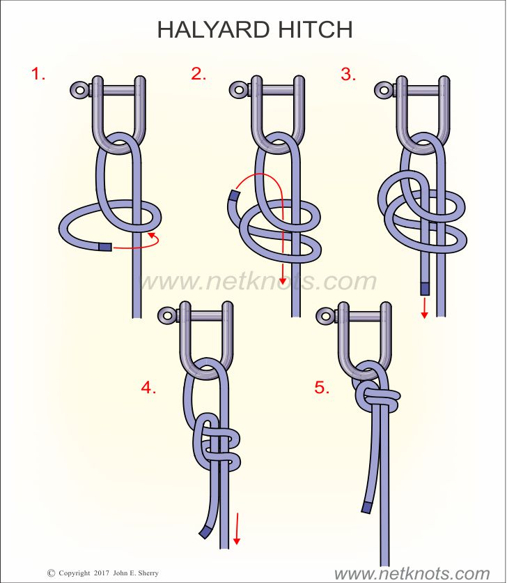

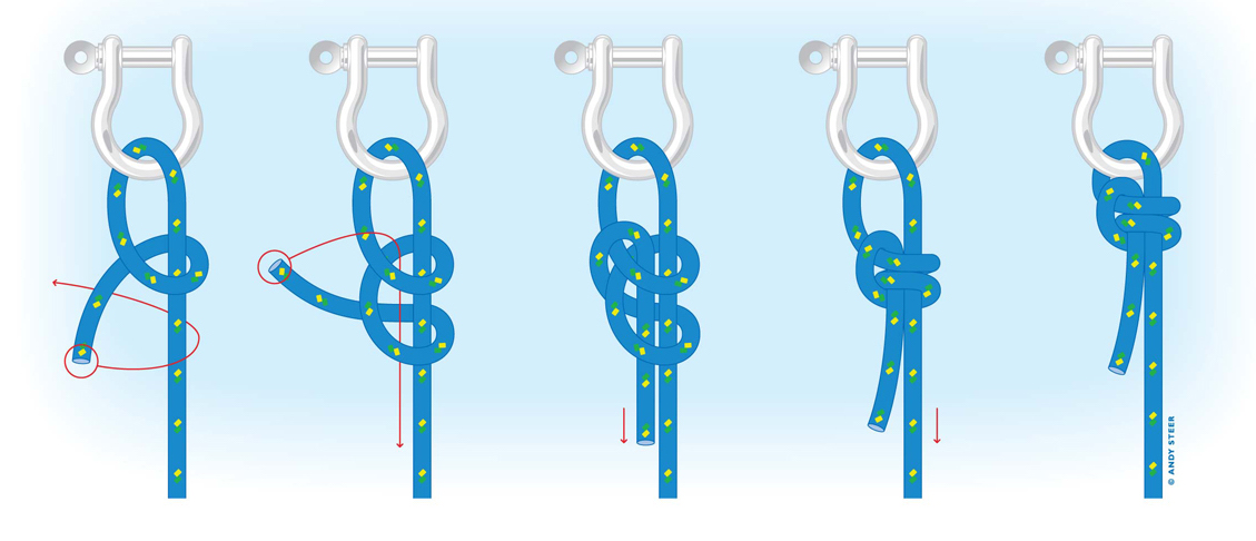

    Seems there are two versions of the Halyard hitch.. One has the bitter end go back up through a couple of loops while the other has the bitter end sit below the loops.. Which is the preferred one or is it a "how long is a piece of.... umm... rope" question?

    Don't know about 'preferred' but I use the one with the tail parallel with the halyard.

    Quote Originally Posted by vyv_cox View Post
    Need to be careful with this as when the halyard gets to the end of it's travel or an obstruction, it is possible through pulling the halyard to poke the bitter end back in the direction from whence it came, loosening the knot.
    Might not happen in practice on a halyard hitch, but a reason why some knots need the bitter end to lie in a particular direction - dependent on application.
    In this version, the end could be pushed back into the knot if it was regularly pulled into an obstruction ...
    In this version not possible ...
    Me too. It is simply an incomplete fisherman's bend round the standing part. Described in the Selden "Hints and Advice on Rigging and Tuning". When loaded it tightens up hard and won't shake loose.

    I don't care what net knots says, I don't think that is a halyard hitch. It is a double overhand noose, AKA poacher's knot.
    https://www.animatedknots.com/halyard-hitch-knot
    https://www.animatedknots.com/poachers-knot
    https://www.youtube.com/watch?v=mqzJj6lYtj8
    Little chance of poking the end through. I need pliers to undo mine at the end of the season.
