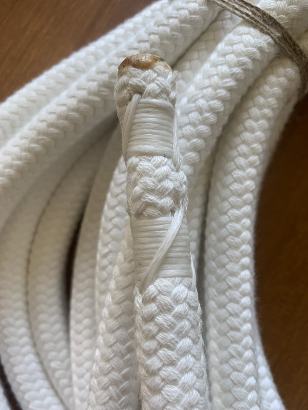

    I doubt if this looks professional but I just whipped the end of my new mainsheet; took maybe five minutes. I always put two whippings on:
    The rule of thumb is that the whipping should be as long as the diameter of the rope and if you put two on they should be separated by one diameter also.
    The ideal way to end a halyard that you want to unreeve and replace with a mouse line in the winter is to point it and add a becket.
    See Admiralty Manual of Seamanship volume two:
    Works with braid on braid and braid on anything else - just taper the core, make an eye with small stuff, whip the eye to the core, slide the sheath back up to the eye and whip that.
