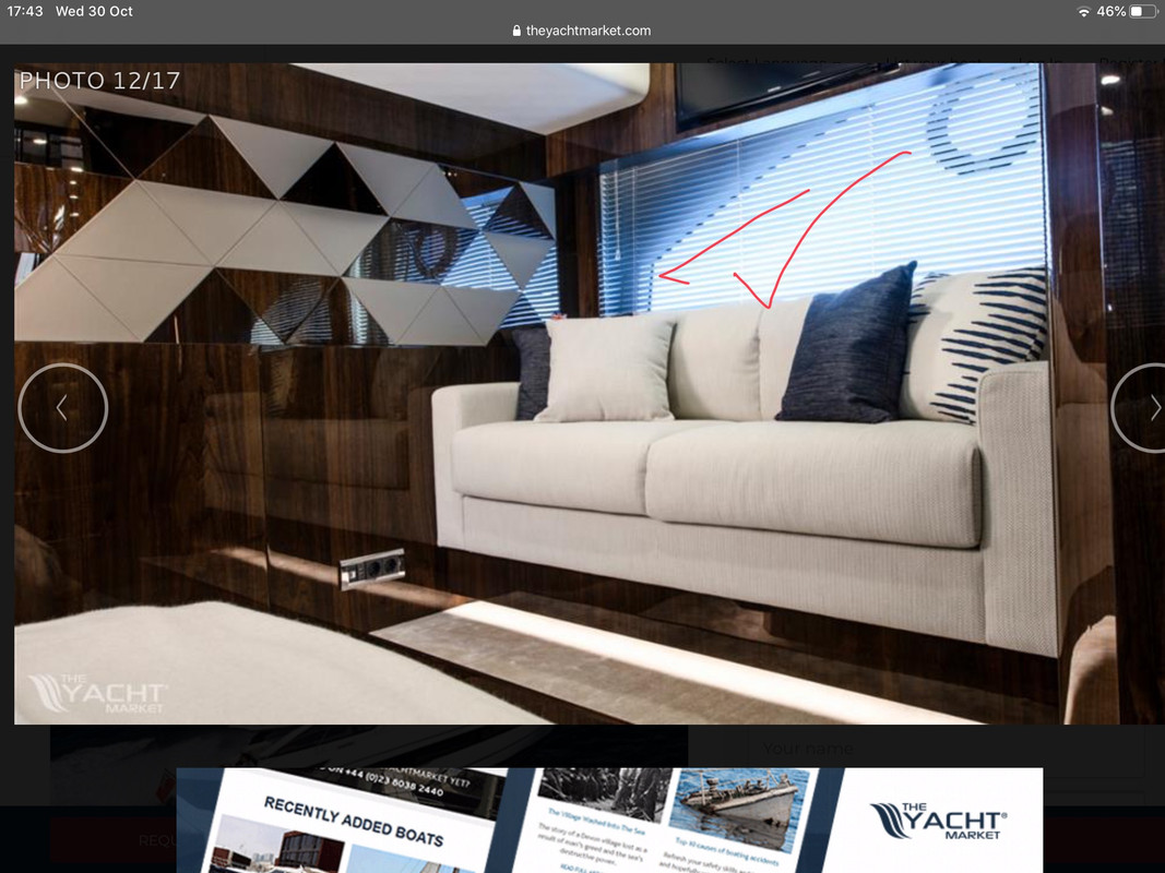

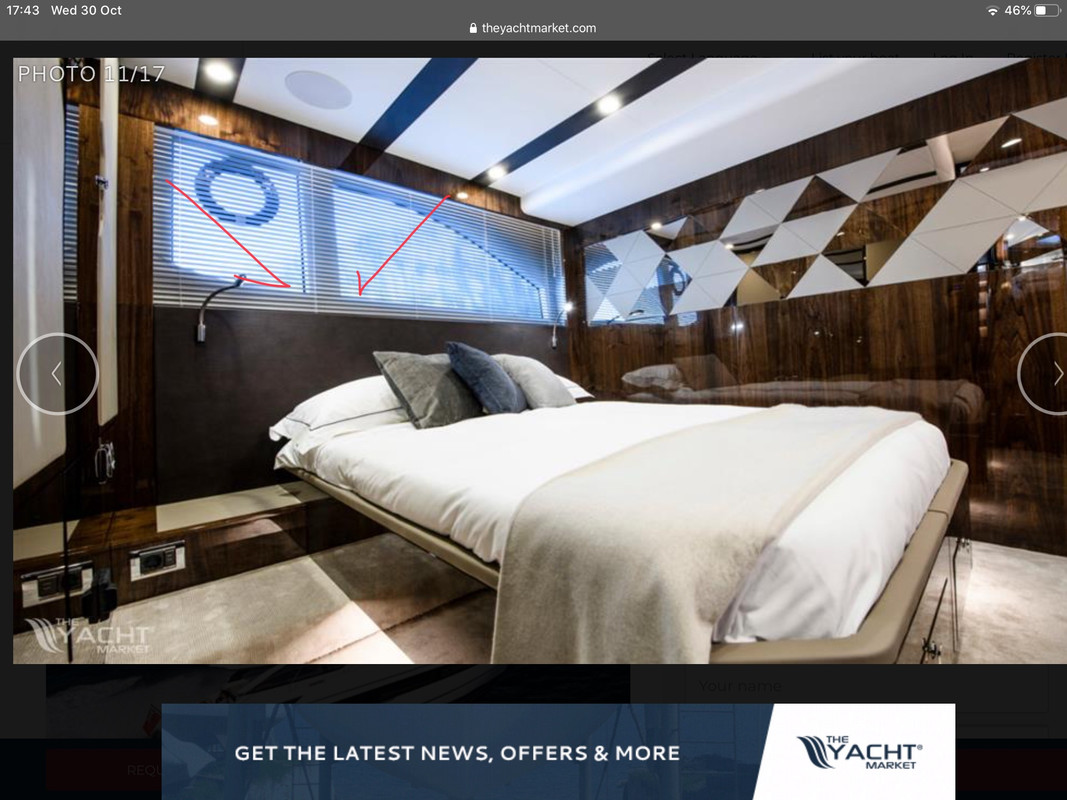

    Appears to have a large glass / acrylic side window ...bonded in .
    Something that long will add to the structural integrity in theory.
    1 - How ever if the hull part is flexing too much then the seal compound may fail and let rain water in .
    Itís either failed glass to compound or hull to compound.
    2 -Another explanation could be the HT runner drains detached .
    There should be some drains in the four corners marked in yellow to either a outside drain or internal sump like a shower pump box ? Or worse still the bulge ?The yellow dots are water escaping after a rain fall on the side boat pic .
    3 - delamination of the HT glass seal ( flexing ) and water running down to the cabin below after flooding the cabin ceiling to the end .
    Blue is the flex .Red delamination points .Yellow drains ? Dot yellow water escaped.
    Red leaky glass at the corners .
    Cockpit roof drains ? Are they connected ? Are there any ?

    There’s a mullion on the headboard side but not on the sofa side ?
    So which side presuming the bigger area sofa side .......more likely to flex and bust its seal .
