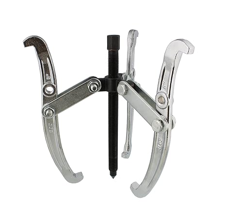

    I would use a gear puller like this to put a steady load into the steering wheel hub.

    You shouldn't need anything as drastic as a puller, unless corrosion has set in badly!
    Undo the nut a few turns, wobble the wheel using the rim at 12-6 and 3-9 positions and it should work off the taper/keyway. Once loose undo the nut fully and take off wheel. Make sure the key on the shaft is not loose, and doesn't fall out of the slot. Wrap some tape around it if it's loose so you don't lose it whilst you're repairing the wheel.
