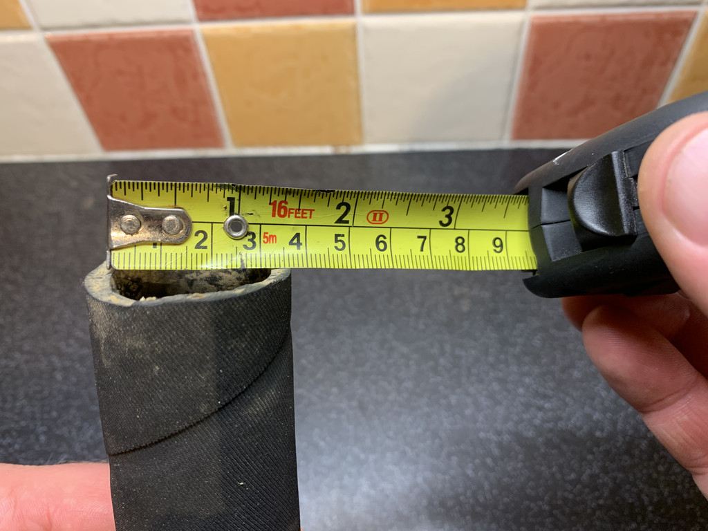

    Bruce you may have missed one of my questions as the thread moved on somewhat.
    So that I can make up a pipe prior to going to the boat (It is some way from me) do you know what the dia of the inlet pipe at the water pump would be ?. Searching the net cant seem to find this out
    Thanks
    I honestly cant remember. It was several years ago I bought the hose for it. I'm sure it's 25mm but dont curse me if I'm wrong and you dont have corroboration.

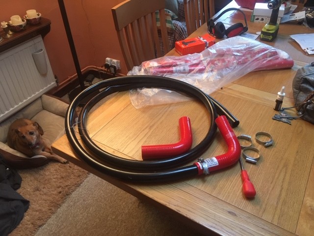

    Quote Originally Posted by stelican View Post
    +1
    That is interesting. I have ordered a pair with straight edges and a flexible inlet to see if I can get them on the drive as I would prefer this method
    Only ever look down on a person when you are bending over to help them up.

    Quote Originally Posted by Bigplumbs View Post
    I did the same but they simply wouldn’t work - just couldn’t get the engine to pull the anti-freeze through so ended up using the pipe to the intake on the raw water pump and bucket method.
